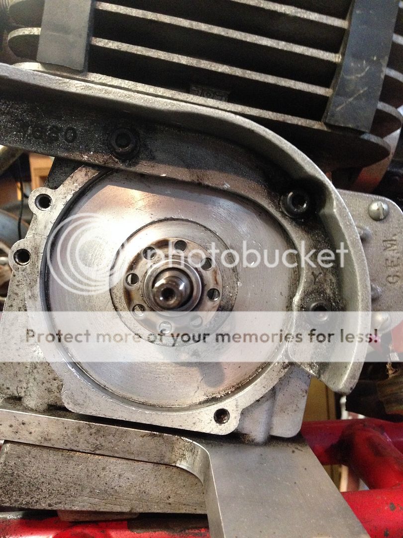

      If that is the bent part I hate to tell you this…
      But that is the crank

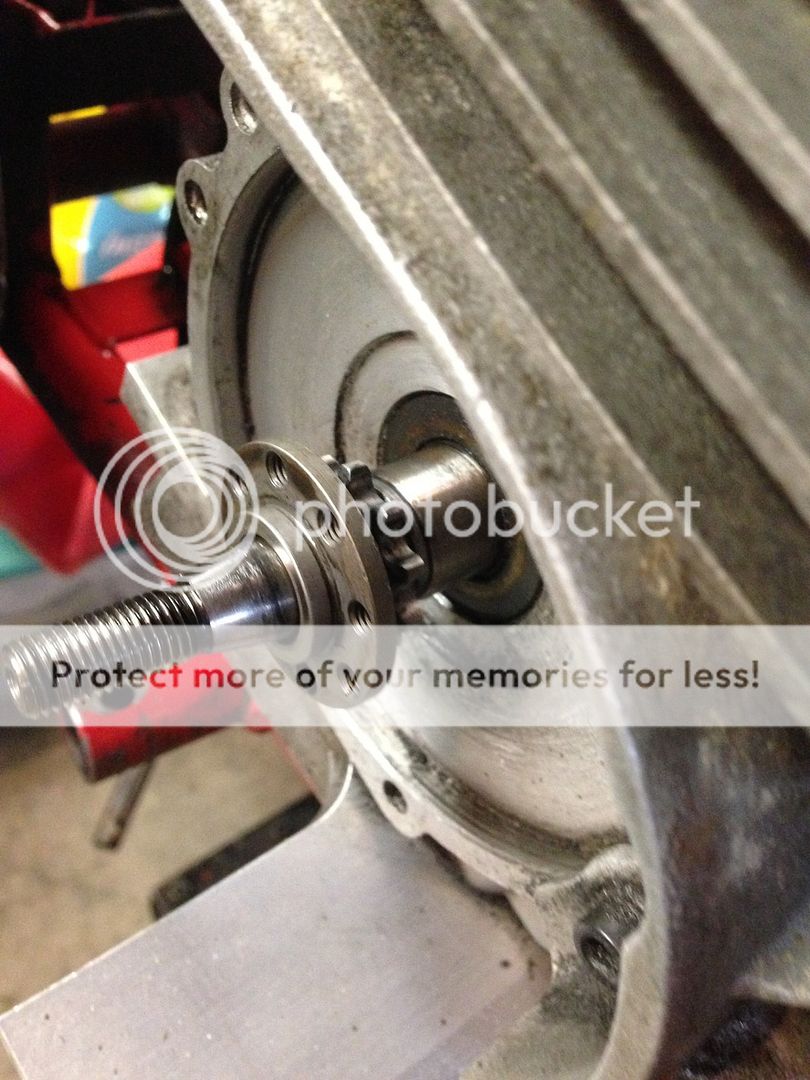

      Welcome to karting. First, out sport does not run in parking lots or on streets because it is not safe. Contact the Badger Kart club for a proper place to run your kart. http://www.badgerkartclub.com/
      Second, I don’t recognized the clutch, but that remaining part seems to be past the taper on the shaft. If that part spins in the on crank shaft, carefully pry the woodruff key without damaging the shaft and try to pull it off by hand. At this point if you see any wobble in the crank, take it to a kart shop as you won’t have the tools to re-align or replace that side of the crank. It would be a good to take it to a shop any way as you probably don’t know how much time is on this motor.

      Erich Moorman
      To clarify, the bent portion is from the sprocket onward, the remaining axle(crank) towards the motor is true. The remainder is where the clutch sits on, and since that tension developed from most likely catching the chain is where it bent due to the leverage.
      I have a contact by me, Franklinmotorsports.com to try my luck with.

      Erich Moorman
      Well found out the part which is broken. Crap
      [URL=http://s1346.photobucket.com/user/Erich_Moorman/media/YAM-KT-7YA-11412-10-00_zpshkn42ceq.jpg.html][IMG]http://i1346.photobucket.com/albums/p698/Erich_Moorman/YAM-KT-7YA-11412-10-00_zpshkn42ceq.jpg[/IMG][/URL]
    • #46062
      Steve O’Hara
      The part with the sprocket should spin freely on the crank and slide right off if the key is removed. The picture of a replacement crank half is the other side of the crank where the ignition rotor mounts. It has a different taper and thread size than the clutch side.
      If you are near Franklin take the engine there and get some good advice on the required repairs.

      Brian Mead
      +1 go to Franklin, crank halves aren’t cheap and you need a press and someone with experiance with a brass hammer to get it put back right. Please, as Tony said, do not run anywhere but a track. People are not looking for you, can’t see you, and will run over you.
