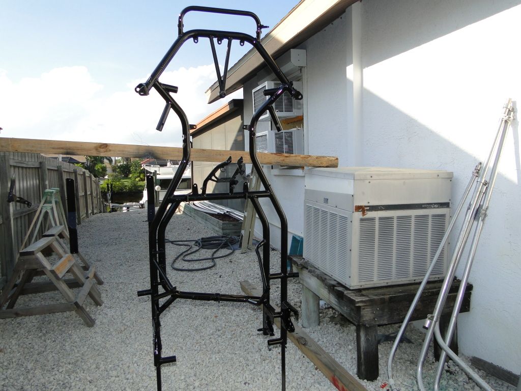

Powder coating is generaly more chemical resistant than paints. If you want an absouloutly chemical resistant coating go Awlgrip. It's primarly a marine paint (I own a company that builds tug boats). I sandblast then coat with Awlgrip 545 primer then an awlgrip topcoat. It is a no maintenace coating that is UV and chemical resistant like no other paint I'm aware of. No chemical you will be using will hurt it. I'm doing a kart now I'll snap some pics and post them hear.

PostPosted: Tue Oct 09, 2012 2:32 pm    Post subject: Reply with quote
Blasted etch primer black Awlgrip

PostPosted: Tue Oct 09, 2012 3:41 pm    Post subject: Reply with quote
Nice looking paint job.
Now i'm gonna resist the urge to ask about the 2 window shakers in 1 window Shocked

PostPosted: Wed Oct 10, 2012 8:25 pm    Post subject: Reply with quote
don't you guys have to sandblast the paint off the frame before painting it?
I too would like to paint my frame in the future. In the mean time to prevent rust I am thinking of just spraying the bottom with some black paint. (the fame is black)
How long did it take to take the chassis apart? I am very tempted... it seems like its about just removing the rear axle and the front wheels.

nice paint job
butt.... the 2 ac units in one window ???

PostPosted: Thu Oct 11, 2012 4:56 am    Post subject: Reply with quote
It took me around 4 hours to remove everything from the frame. I think sandblasting is a must.

PostPosted: Thu Oct 11, 2012 6:25 am    Post subject: Reply with quote
It usually takes me 3-4 hours to totally disassemble a kart, then at least that long to reassemble it. The pedals, braking system, fairing...it all adds up. Mine are Tag karts, so you've got the electronics, battery box, etc. It would take less time for a 100cc kart.
My guy uses chemical stripper instead of sandblasting, although either method seems to work fine.
Once you get it done, I highly recommend some sort of plastic frame protectors for at least the waist area and perhaps the front tube. My driver has a habit of driving straight over the top of any curbing if its the fastest way around, regardless of what it does to the underside of the frame. Sacrificing the plastic guards over chassis metal is a must for my karts. J3 offers some nice guards as well as VerdeSpeed. Both do the job.

PostPosted: Thu Oct 11, 2012 7:27 am    Post subject: Reply with quote
I like that better. I had my chassis sand blaster and it was super rough. So the powdercoater laid on the finish super thick so it would be smooth but it now cracks off and smoches too easily.
