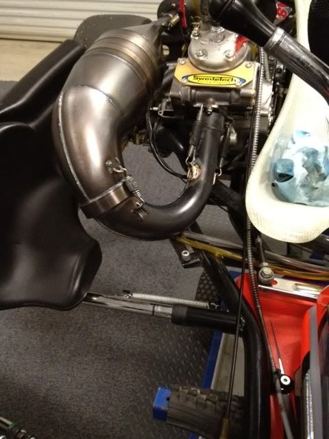

PostPosted: Tue Oct 09, 2012 4:06 pm    Post subject: Reply with quote
Ill take a pic tonight and post on here.

Jimmy McNeil

Sam Zavaglia
Joined: 23 Nov 2004
Posts: 1181
Location: Australia, Sydney,
PostPosted: Wed Oct 10, 2012 3:53 am    Post subject: Reply with quote
Thanks for the picture Jimmy.
Will the original R4H still be made available in future or is it all going to this kind of design?
How is this going to affect the 'spec' class using R4H?
Surely there must be a slight difference in performance either better or worst?

Steve Buckner
Joined: 22 Apr 2003
Posts: 839
PostPosted: Wed Oct 10, 2012 5:37 am    Post subject: Reply with quote
They copied the cr250 two peace pipe design.

Jimmy McNeil
Joined: 12 Apr 2006
Posts: 1457
Location: United States, California, visalia
PostPosted: Wed Oct 10, 2012 9:40 am    Post subject: Reply with quote
Sam, it dyno's the same. I've done many back to back sessions with it and cannot tell a difference.
Makes the pipe easier to mount, you can take it apart to clean it out and if you damage it you will be able to purchase the half you need.
Howie Idelson
Posts: 1336
Location: United States, California, Pacific Palisades
PostPosted: Wed Oct 10, 2012 9:58 am    Post subject: Reply with quote
Why can't they stamp the whole back half? That rear section could be done with no welds except for the seam down the center making it more robust and durable. Also less prone to fiddlers.

PostPosted: Wed Oct 10, 2012 4:22 pm    Post subject: Reply with quote
Yah, then they would crack the entire length!!!! I think JM tried that....
