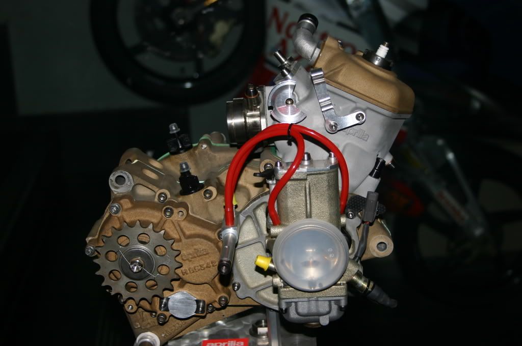

Or you could do this:
Aprilia's last magnesium cased RSW with APF cylinder
