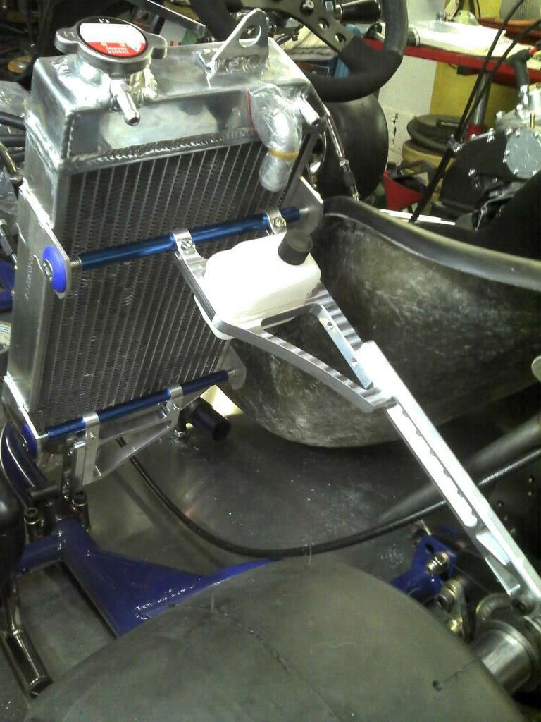

PostPosted: Fri Oct 05, 2012 10:07 pm    Post subject: Reply with quote
Steve Buckner
Joined: 22 Apr 2003
Posts: 839
PostPosted: Fri Oct 05, 2012 10:08 pm    Post subject: Reply with quote
Cool Cool Cool
Chris Fosso
Joined: 01 Jan 2009
Posts: 192
PostPosted: Sat Oct 06, 2012 4:03 pm    Post subject: Reply with quote
that radiator is nice!... the price is not though Smile
