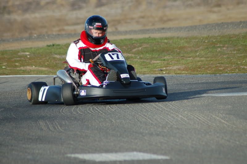

i notice on some quick sweepers turning left mostly, that my front left wheel comes off the ground quite a bit, on my 125cc shifter, kart feels good, but i can only put down 80% throttle coming out of corners from a push..
32mm chassis no rear bar, do have side and front.
med axle med hubs, caster is aggresive.
415lbs with driver im 6 205lbs. 2 strut tight per side, seat is just under frame. 13psi yellow cold off track 15.5 all 4 corners.
stock moto set up with swedetech stock moto muffler.
Thanks
