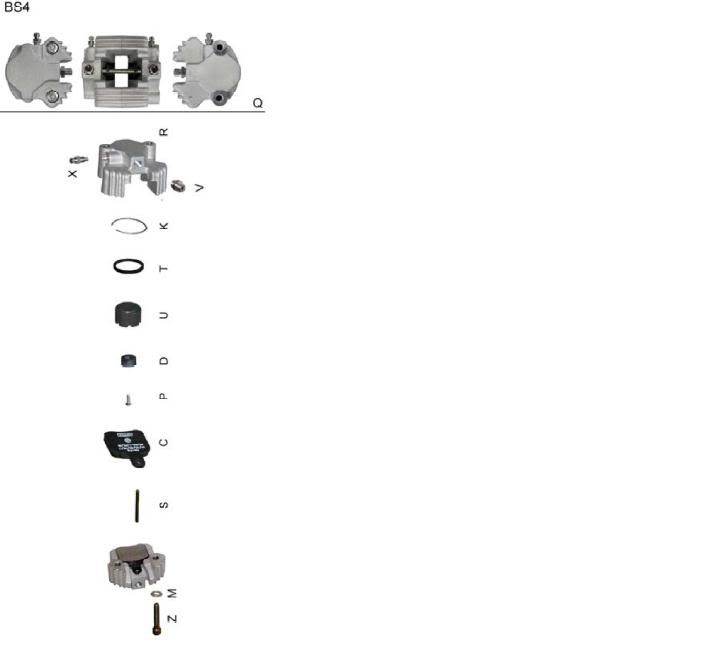

Here is a detail assembly of the bs4 brake caliper.
-Remove the two allen head bolts (Z)
-Remove retainer pin (s)
