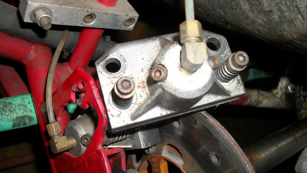

I purchased this kart used back in 2002 and it was an older chassis then and am not sure of the year (neither was the seller). Anyways, I'd like to replace the brake pads so it stops again but do not know what they are. No markings on them but here's some pics:

Get out the calipers, I mean the measuring type!!!
Chuck, those pad numbers usually transfer to different brands of pads also.
http://www.ebcbrakes.com/redkart.html

looks like the same caliper/pad that Top Kart used. I would look on the web at Comet Kart sales on line store. They show pads with dimensions you can measure yours and match.
Good Luck
