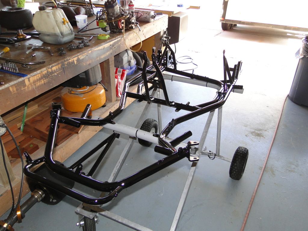

I'd suggest bead blasting (tiny glass beads) rather than sand blasting. Not only does bead blasting avoid the rough surface Mr. Helmet noted, it's less likely to add/change local stresses in the frame.

you've got to blast with the right abrasive. Very fine for a kart frame that gives you a surface that's about like 400 grit paper. That will get you a good tooth but won't require a big build up of coating to be smooth. BTW never blast the floor pan it's to thin you'll distort it.

Exactly.... If it's been powder coated prior, some guys will chemical strip first, then blast. Mike, that's probably why it came out rough, they went with an aggressive media to strip the old Powder off it... They even have fillers and primers that work with powder coating.....

Sprayed mine with truck bed liner. It's at least as tough as powdercoat, if not tougher. It does come out a little rough, but a quick sanding with some 400 grit smooths it out and makes it easier to clean.

Yeah spray bombs aren't very good. The problem I see is that karts are normally done with automitve paint and it's just not adequete on a kart that's going to to be wiped with cleaning solvents stepped on etc. As I said earlier marine and industrial coatings like Awlgrip work very well in all respects.

Look into DuraCoat. It is ultra tough, very durable, and resists chemicals used to clean firearms (similar to brake cleaner). I did a frame with it last year, turned out great. I will likely refinish my current kart over the winter.
