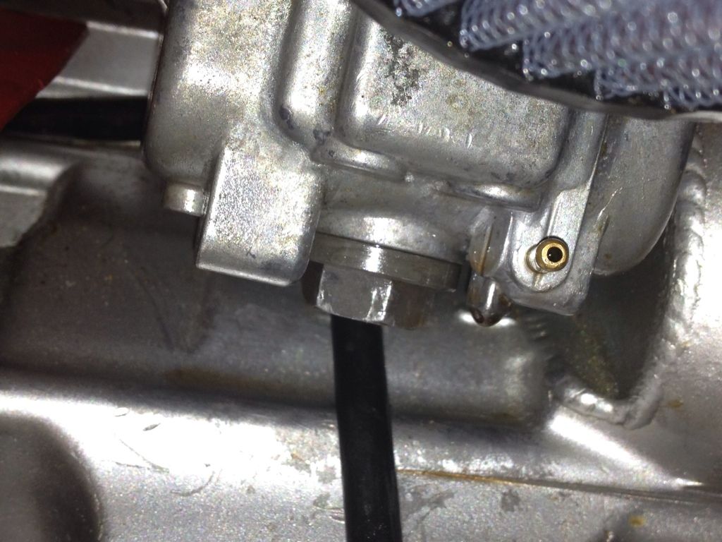

Starts fine, Runs fine, but while idling it poors fuel out of the bottom of the float bowl at the brass fitting in this picture.
Why, and what can you tell me to correct the problem that JUST started?

Are you running a pump around? (I assume not).
This can only mean that at idle you have too much fuel pumping into the bowl and not enough leaving the bowl (going into the engine). I would guess that your not getting enough fuel flow through your idle jet. Try pulling apart your carb and cleaning the jets.
BTW, cleaning the jets doesn't work with just some carb cleaner. You have to get in there with a tiny wire and brush back and forth through it. The gunk that gets in there takes some elbow grease.

Ray you assume correctly! No pump around. When I first had it plumbed it didnt do this but than a fellow karter who frequents this board whom Ive never met other than on FB said to re-plumb my system as he described using NO T's and NO Y's and NO inline filter of any kind BUT to be sure to filter fuel before pouring into tank using a coffee filter or such!
I have one line coming from tank to IN on pump, one coming from pulse on engine to IN on pump, one coming OUT from pump to carb and one coming OUT on pump back to tank!
Thats it!
Could this be my problem because it only started spewing fuel after this plumbing change?
Benn Herr
Posts: 1580
PostPosted: Wed Sep 19, 2012 1:39 pm    Post subject: Reply with quote
Yes, the plumbing change caused your problem.
Unless your carb is equiped with a small inlet seat, a pump-around, a certain DelOrto fuel pump, or some other kind of bypass system, the fuel will just blow right out of there.
In no way will the stock Kehein needle and seat handle full pump pressure.
Put it back to the way you had it and go from there.

Okay I came home and started by installing a T in the line going TO the carb and a T in the line from the pump returning to the tank, then connected the two together. Dont blame me if its wrong. Heck Im at a guessing stage on this but the main thing is after starting and running, all fuel lines stay full and NO fuel is pissing out of the bottom bowl fitting!

With the plumbing you described: put a tee in line between pump and carb. Now run line from tee back to tank. Excess fuel will bypass back to tank.

Keep the lines routed as I told you. They are right. Period. Your issue is in tank venting, not enough. When revving and driving, the carb is burning the fuel, and less is going back to the tank. When idling, most of the fuel is being returned, but without enough vent, it will push the inlet needle and overflow the bowl. Dont change the line routing, just increase the fuel tank vent opening or add another line. I guarantee your problem will go away.

Pull the cap off the tank fuel while idling and see if the issue goes away. That will answer the venting question for you.

Fuel does not return to tank at idle. The idle circuit is in control at closed throttle providing only enough fuel for idle. I've plumbed a few Keihins and using a tee is simple and effective. Or you can go with a Dellorto fuel pump which has an internal bypass circuit. I have customers who have purchased Dellorto pumps specifically for CR engines. But be sure to vent tank.
