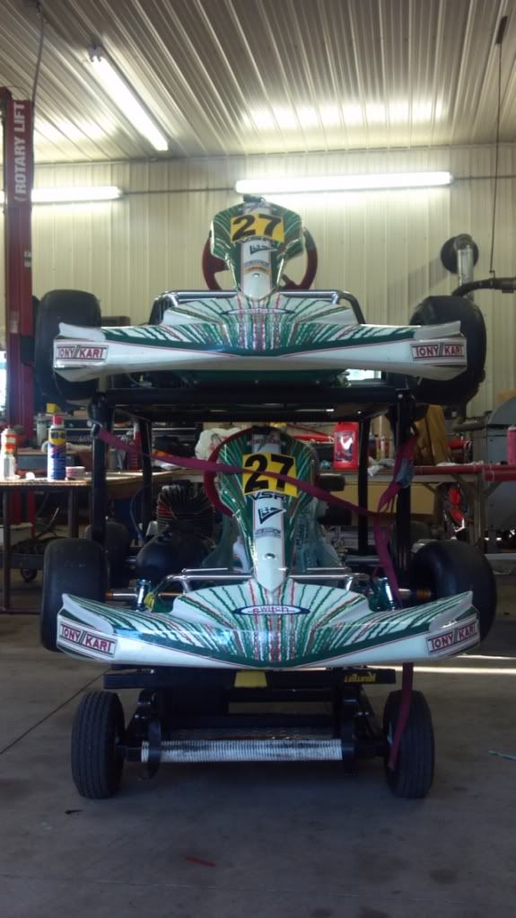

This is what I use. I can put 2 tag karts that weigh #230 each and a WinchLift powered lifting stand all in the space that one kart takes. Its called the WinchStacker (pat. pending). It works quite well, although I may be a bit partial. Wink
The only downside is that you do need help stacking the karts up at the end of the day.
The picture shows a customer's setup with TonyKart cadets, but I used it with Tag karts equally well.
