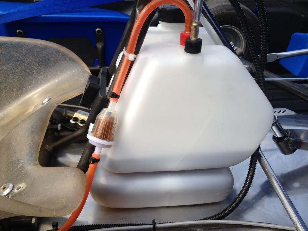

The last is my new fuel tank and filter

I would get a Walbro fuel filter. Those paper automotive filters give off fuzz that clogs the carb screen. The fuel line going to the carb should be safety wired to prevent an air leak which is a problem on these karts. That orange tubing gets rock hard pretty quick, I use Tygon tubing. Also, I'd put the other 3 bolts in the sprocket, if you put a wheel off the track it will be less likely to bend. The exhaust springs should wrap around from top hook to bottom not go straight across, you'll probably need longer springs for this. Don't know who milled those too big slots in the clutch support but I hope that don't break. There's a bolt missing in your chain guard.
Gif Cool
Gif Cool
Thanks Walt I'll be going down to the shop today to get the new filter and some hardware for the rear sprocket and to look for the new fuel line. While i haven't done it yet, putting a wheel off the track sounds like a real possibility for me right now. I use safety wire when i take the kart out to the track. I have to store my kart vertical so i pop the hose off and blow the fuel back up the line so it doesn't siphon when storing it. i don't know how long that bolt was missing out of the chain guard but i had noticed it after taking the pictures. its been replaced. Which springs are incorrect the set on the header or the one on the exhaust support?
-Bill
