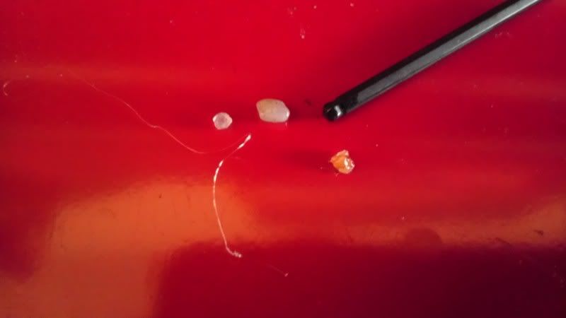

I believe I may have found the issue.
In the picture is a 2mm allen wrench. Yes, I found three pebbles and a piece of hair in the supply pump. The previous owner didn't have a fuel filter when I bought the kart.
2008 Mike Wilson with Honda CR125 shifter
