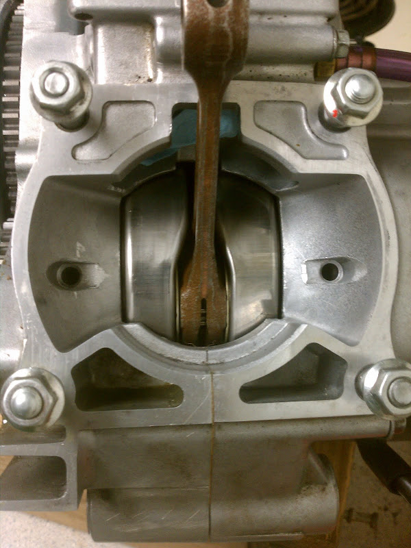

mainshaft....well if the cases are silver and NOT stripped or blasted, you have a 95' and newer cases........96' and 97' cases used the longer mainshaft...90'-95' cases would use the shorter main shaft......Take a pic of the base gasket surface of your cases so we can see the transfer port shape.........angled tranfers (90'-97') straight transfers (98'-02') point being if you have the straight transfer ports you need the longer mainshaft as well as if they are 96'-97' (silver angled transfer port) cases, I am confusing myself..........the only silver case that would use the short mainshaft would be 95' there is no serial # on your cases?

Is this?
No serial number on cases

OK from looking at your transfer port shape (square) you have 98-02 cases, no serial number probably means they were replacement cases (maybe a kit motor) not from a bike engine......You need the later longer 96'-97' mainshaft part number 23210-KZ4-A10. The early gears will fit and work on the later shafts but make sure the shims, spacers, clips are all there and in their proper place. I just went through the same problem with a 6 speed 97' tranny that I bought here on the forum, the countershaft was bent (never seen that) and the mainshaft was the early style, so much for a good used tranny, cost me about $450 when I was done....
